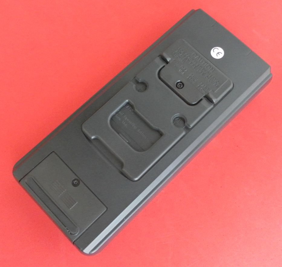

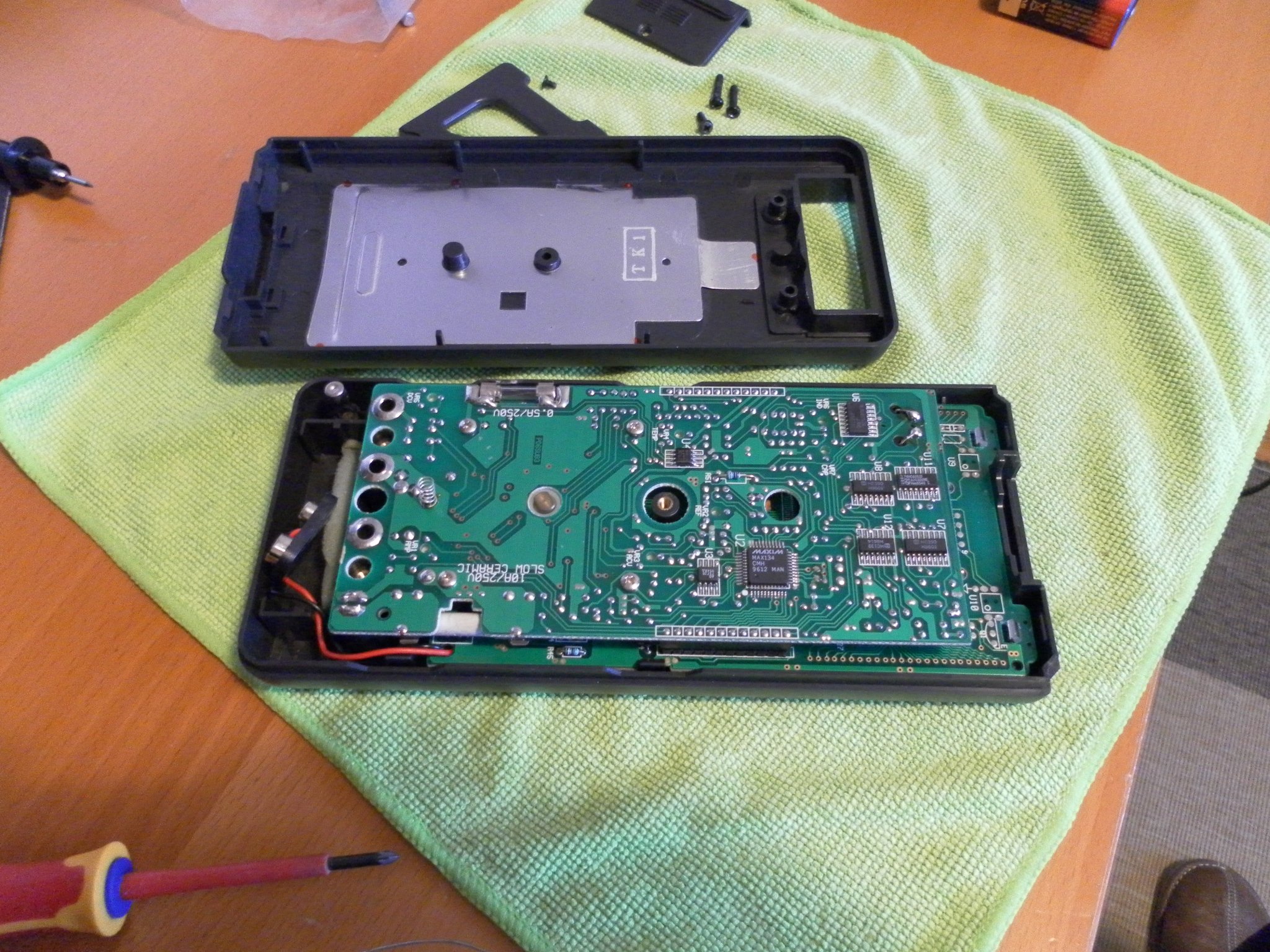

Hello Sercan,
I have the original plastic case with user guide and temperature probe. I can't take pictures because I am away from home.
I have a few old equipment in my modest collection, mainly radios, and some equipment including a Centrad Oscilloscope, two Flukes (Counter and DMM), A Siemens uA centre scale analog current meter, among others.
I am member of the Swiss virtual museum at https://www.radiomuseum.org/collection/jose_mesquita.html
I have a local copy of pictures of my radio/equipment collection uploaded to the RadioMuseum.
Here some pictures of my 505:
    110.6 KB · Görüntüleme: 195
    72.7 KB · Görüntüleme: 174
    93 KB · Görüntüleme: 168
    116.7 KB · Görüntüleme: 166
    152.2 KB · Görüntüleme: 177
    658.6 KB · Görüntüleme: 184
