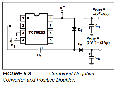

• Simple Conversion of +5V to ±5V Supplies

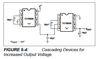

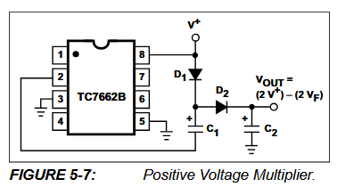

• Voltage Multiplication V OUT = ±nVIN
