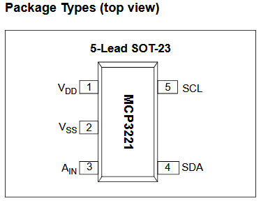

MCP3221 Low-Power 12-Bit Analog-to-Digital Converter with I²C Interface
Features
• 12-bit Resolution
• ±1 LSB Differential Nonlinearity (DNL) Maximum
±2 LSB Integral Nonlinearity (INL) Maximum
• 250 μA Max Conversion Current
• 5 nA Typical Standby Current, 1 μA maximum
• I²C Compatible Serial Interface:
- 100 kHz I²C Standard mode
- 400 kHz I²C Fast mode
• Up to Eight Devices Connected on a Single 2-Wire Bus
• 22.3 ksps in I2 C Fast mode
• Single-Ended Analog Input Channel
• On-Chip Sample and Hold
• On-Chip Conversion Clock
• Single-Supply Specified Operation: 2.7V to 5.5V
• AEC-Q100 Qualified, Grade 1
• Extended Temperature Range: -40°C to +125°C
• Package: 5-Lead SOT-23
Applications
• Automotive
• Data Logging
• Multi-Zone Monitoring
• Handheld Portable Applications
• Battery-Powered Test Equipment
• Remote or Isolated Data Acquisition
