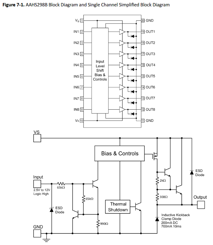

Octal 75V, 700 mA Source Driver for Space
Features
• 700 mA source current capability per output
• 20 μA max supply current with all outputs off
• Channel isolation to prevent fault propagation
• Internal ground clamp diodes
• 75V output breakdown voltage
• 2.5V to 12V logic compatible inputs
• Internal thermal shutdown
• Radiation tolerant: 100 krad(Si) TID, 50krad (Si) ELDRS, and SEL immune to 117 MeV.cm²/mg and 125°C (fluence of 107 particles/cm²)
Applications
• Relay/Solenoid drivers
• Lamp/LED drivers
• Stepper and/or servo motor drivers
• Aerospace satellite manufacturers
• Military power electronics control
AAHS298B DataSheet

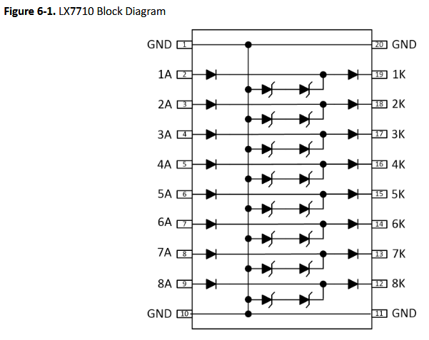

Devrede kullanılan Diode Array çipi de aşağıda yer almakta.
Octal 125V, 700mA Redundant Diode Pairs for Space
Features
• 125V minimum breakdown voltage, even if one diode in any string fails for redundancy
• 700 mA current capability per diode
• Low leakage current
• ESD protected
• Radiation tolerant: 100 krad(Si) TID, inherent latchup immunity due to no power pin
Applications
• Power ORing
• Redundant power sourcing
• Redundant inductive load clamps
LX7710 DataSheet
