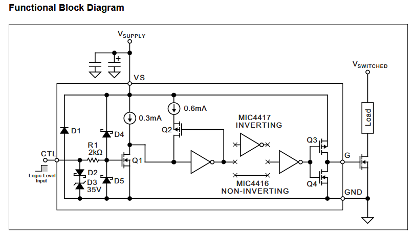

4-Lead SOT-143 (M4) kılıfında
Features
• +4.5V to +18V Operation
• Low Steady-State Supply Current
- 50 μA Typical, Control Input Low
- 370 μA Typical, Control Input High
• 1.2A Nominal Peak Output
- 3.5Ω Typical Output Resistance at 18V Supply
- 7.8Ω Typical Output Resistance at 5V Supply
• 25 mV Maximum Output Offset from Supply or Ground
• Operates in Low-Side Switch Circuits
• TTL-Compatible Input Withstands -20V
• ESD Protection
• Inverting and Noninverting Versions
