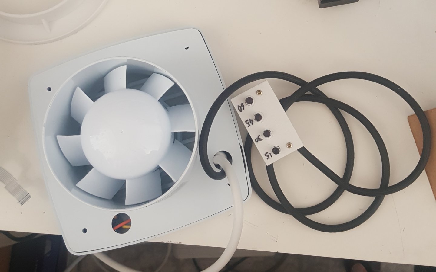

Zaman Ayarlı Aspiratör Devresi
Gökhan abi yazılım paylaşacak mısın ?
#define dk15 4
#define dk30 3
#define dk45 2
#define dk60 1
#define role 0
void setup() {
  pinMode(dk15, INPUT);
  pinMode(dk30, INPUT);
  pinMode(dk45, INPUT);
  pinMode(dk60, INPUT);
  pinMode(role, OUTPUT);
  digitalWrite(role, LOW);
void delay_seconds(unsigned long saniye)
  digitalWrite(role, HIGH);
    for (unsigned long i = 0; i < saniye; i++)
        delay(988);
void loop() {
  if (digitalRead(dk15))
    unsigned long san = 900;
    delay_seconds(san); //900,000 15dk
  if (digitalRead(dk30))
    unsigned long san = 1800;
    delay_seconds(san); //1.800,000
  if (digitalRead(dk45))
    unsigned long san = 2700;
    delay_seconds(san); //2.700,000
  if (digitalRead(dk60))
    unsigned long san = 3600;
    delay_seconds(san); //3.600,000
