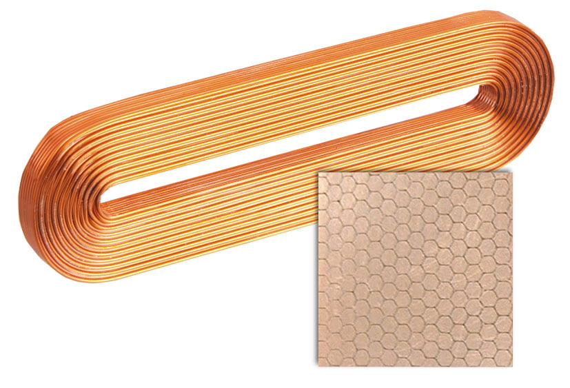

Pek cok avantaj getiren özel sarım şekli.
![www.kukcoils.com](https://www.kukcoils.com/hubfs/03_blog/Manufacturing%20partner/Orthocyclic%20coil%20winding%20%28cross-section%29.jpg#keepProtocol)
What is the advantage of orthocyclic windings?
Orthocyclic coils are characterised by a high copper fill factor, so that a comparatively high magnetic field is realised in the smallest possible space.
